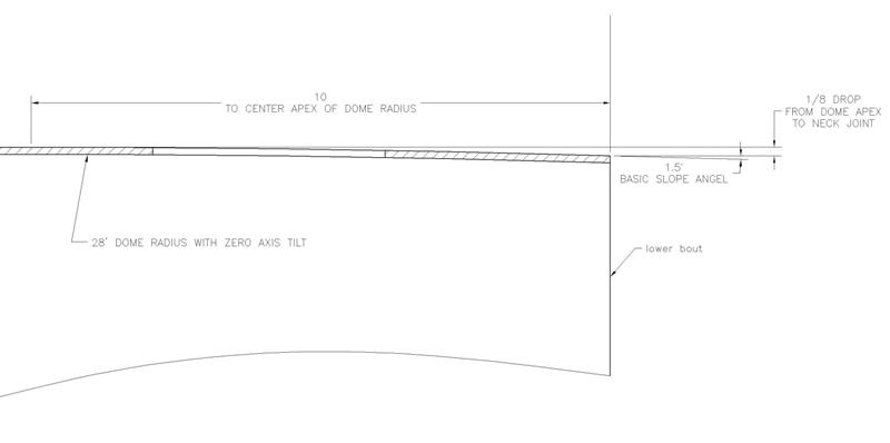

PostPosted: Fri Sep 29, 2006 4:03 am
I use a 28' radius. I used autocad to determine the apex location and axis tilt so that the dome provides a near 1.5 degree average slope at the lower bout. I don't final level the fret board till it is fitted and final mounted mounted. This leaves me enough material on my fretboard to level to the bridge to fretboard plane relationship I want. Obviously this means I don't fret the fretboard till the neck and fretboard in permanently mounted. I find this leves me room to fix minor errors in the fit up if they should pop up like 14th hump
Here is my SJ dome apex position
MichaelP38989.6076041667
